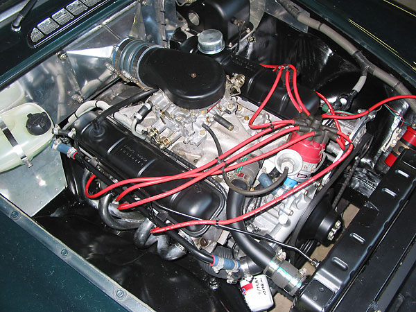

In searching for the perfect home for my new remote oil filter, I ended up here on the inside fender surface just above the engine adapter. I know most weld a bracket here but I am wondering why that is even necessary. Since the pump is doing the work, it would seem that gravity plays no real role. Other than managing a little mess when removing the filter, why can't I just bolt it in this position? It's a straight shot with no elbows and the hoses clear the radiator hose.
Thoughts?

I came out the bottom of the adapter, and ran hoses under the frame to a spot behind the headlight. That way you can mount it right side up for easy changing. Also removes the heat from the engine bay.

D&D swivel base & 7/8" sway bar.
http://www.britishv8.org/MG/CarlFloyd/CarlFloyd-D.jpg
