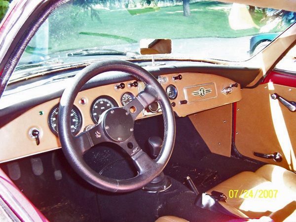

I use the GM T5 and have no difficulty with the shifter being slightly offset.
