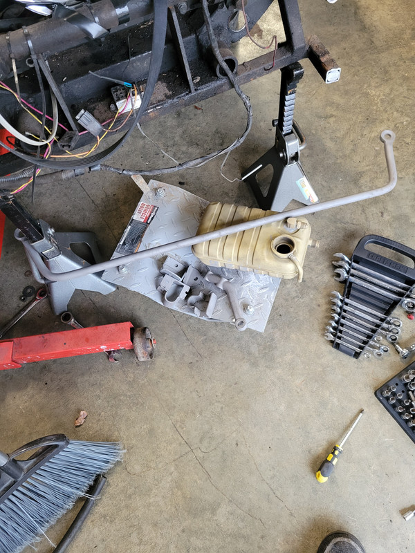

Sandblasting the next round of parts so I can powder coat them this weekend. Front sway bar, some brackets, etc... going to pull the springs and other stuff out from the rear and go over them as well this weekend. Nice that ever thing fits in the oven and cabinet.
https://i.postimg.cc/RFcwxhpw/20210312-164835.jpg

It's pretty reliable these days. I invested in good equipment and good powders and I make sure to clean the metal properly and off gas it at a higher temp than the curing temp for the powder. So far the results have been good and every time I do it it gets better and better and I learn more. Definetly sticking to the epoxy coatings on the frame though, since putting that into the oven and sand blast cabinet isn't practical... or possible. I'll still ensure that the frame is cleaned properly and residue from all oils, etc is gone before painting. Trying to make this the last time I have the car apart.

I got a lot done today... not as much as I wanted, a few of the parts weren't stripped as well as I wanted do I didn't coat them. Ordered a ton of parts that I needed and went digging through old boxes to find parts that I hope I can use on this one... QA1 double adjustable shocks... yeah, they are for a camaro but I hope to make them work. Also ordered fiberglass supplies for the upcoming front end work, and also bushings that I need to put everything back together. I think I'm going to redo the expansion tank so that I can clean it all up a little nicer. Slowly getting progress in but at least it's progress...
https://i.postimg.cc/SsX9G6rh/20210314-173731.jpg
Shinyness comparison... not quite chrome but still pretty nice.

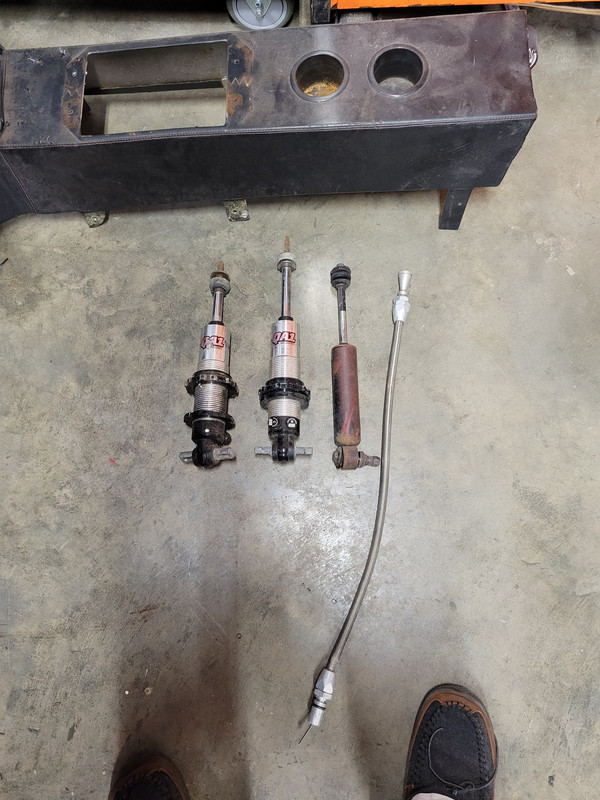

https://i.postimg.cc/CLwQc5W2/20210314-183348.jpg

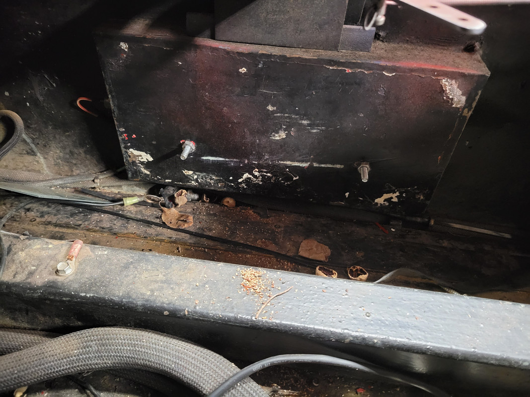

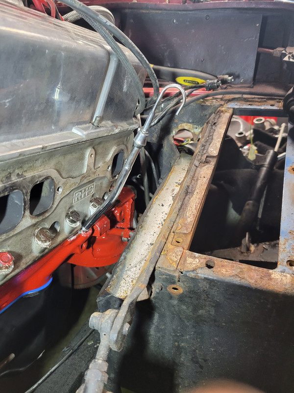

Nothing too terribly crazy going on, besides an insane amount of rain... I moved just about everything out of the way on the driver's side so I can get after it this weekend. The plan is:
1) change how the master cylinder is mounted... it sits a smidge too high and interferes with the hood fitment in that area.
2) install the new gas pedal assembly; this time its going to be floor mounted.
3) clean up the firewall and footwell area so it looks a lot cleaner.
4) start fabrication on the exhaust routing from side pipes to exhaust manifolds.
5) finish fabbing up the steering, from the column down to the rack.
Some parts have already begun to show up but a ton are still on the way. Also thinking about installing a line lock this go around. I have one sitting around from a previous project so why not.
https://i.postimg.cc/DwxmzS0N/20210317-194258.jpg

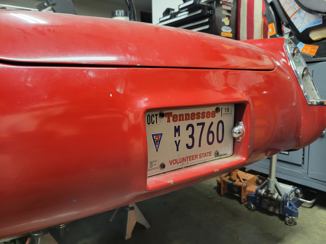

I like your rear license plate surround. Do you have a better picture of it?

Date: March 17, 2021 11:22PM
Sure thing, I'll snap one tomorrow morning from inside the trunk and behind the car.

Jim, I'm a terd I forgot to post these up for you. Let me know if you need particulars and I can measure or take more detailed stuff...
https://i.postimg.cc/L8L2sFKr/20210318-194604.jpgimghost
https://i.postimg.cc/9FkvT8YC/20210318-194537.jpg
