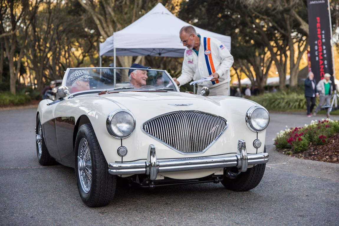

Having owned a 61 4 seater with a built 289 in it, I can testify to the need to get air out from under the hood , especially at speeds under 35 mph. I would definitely either ceramic coat the headers or use heat wrap on them to keep that heat out of the engine bay.. .. If you want to keep the car looking authentic, there are a couple of choices you can make that would be a great help - you could install a BN2 100m replica hood, which had no scoop, but did have two rows of louvers, one on each side of the hood in a semi-V pattern with the edges of the louvers being parallel to the edges of the hood. ....Or, you could install side vents as on the factory rally cars from 1956 - a triangular opening with the upper edge following the body line where the two tone paint line is, and the front edge curved to parallel the wheel arch.
here's the 100M-
[www.sportscardigest.com]
and a rally car-
[www.supercars.net]
Doug
