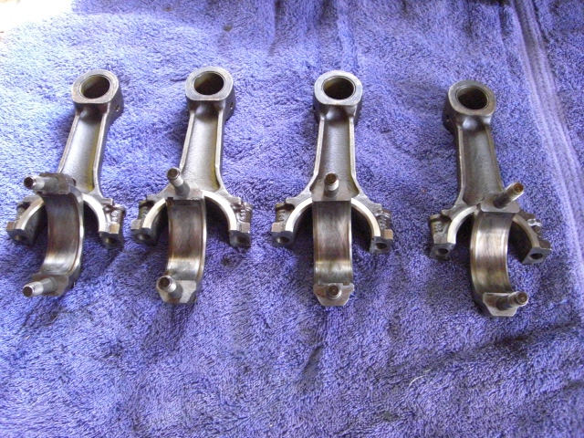

I think this is the rods you were talking about. Wouldn't that put the nut nearer the cam though??

Nic and clan, pic is of a "stocker"? Look similar to my 907,"deisel" rods,900 grams must be, right? VW ,aftermarket, is quite thinner/rounded on bottom. Depends on where they bump. Buick V6 with "even fire" crank, reportedly they bump on top near bolt. "Fat Performance" or "Empi" might have pics'.rovermn.
