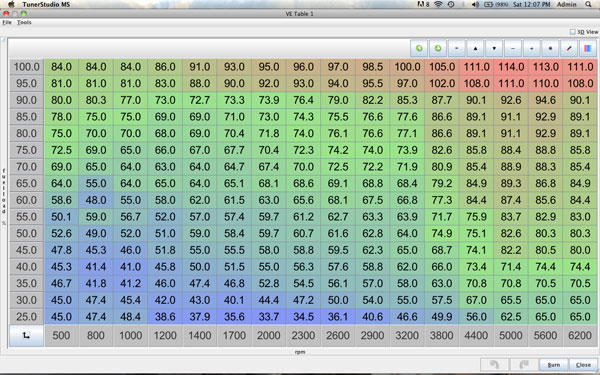

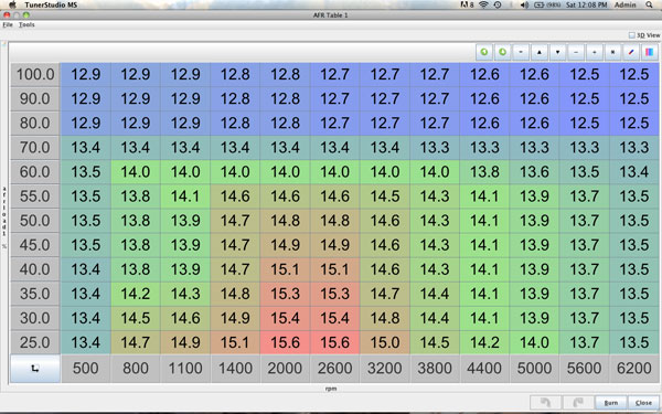

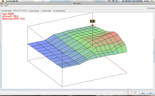

I've improved my tune quite a bit since August, so I thought I'd upload the updated tune file.
This one is much more fuel efficient: My-Buick-Rover-V8-MS3-EFI-Tune.msq
http://www.britishv8.org/MG/CurtisJacobson/AFR-Table-Rover-V8-or-Buick-215.jpg
http://www.britishv8.org/MG/CurtisJacobson/AFR-Map-Rover-V8-or-Buick-215.jpg
http://www.britishv8.org/MG/CurtisJacobson/VE-Table-Rover-V8-or-Buick-215.jpg
http://www.britishv8.org/MG/CurtisJacobson/Spark-Advance-Table-Rover-V8-or-Buick-215.jpg
Comments welcome.
mgb260
Jim Nichols
Sequim,WA
(2633 posts)
Registered:
02/29/2008 08:29PM
Main British Car:
1973 MGB roadster 260 Ford V8
Re: Rover 4.0 & Megasquirt
Posted by: mgb260
Date: October 11, 2014 03:01PM
Curtis, Looks good. I have heard that 12.5 AF for full throttle,13.5 for acceleration and around 14 at idle, but what are you gaining by going over 15 at cruise RPM?

Curtis Jacobson
Portland Oregon
(4637 posts)
Registered:
10/12/2007 02:16AM
Main British Car:
71 MGBGT, Buick 215
authors avatar
Posted by: Moderator
Date: October 16, 2014 12:57PM
Fuel economy to/in/from "The Blacklands" averaged ~2.1mpg better than my cross-country trip on the old tune.
I'd hoped for more improvement! I averaged 24.1mpg, running E10 the whole time and mostly driving "normally" rather than trying to get good mileage. All sorts of roads and speed limits, including 35mph park roads and 80mph highways. Some rushing to get to Moss Motoring Challenge destinations before sunsets. So maybe 24 isn't "bad", but I believe I should be averaging 28 or 30mpg (U.S.) overall on road trips.
As I read up on the subject, it seems I've been overly cautious. Apparently, "cruise" AFRs in the 16-17 to 1 range are common. Even the most conservative articles I've found suggest a target around 15.7:1. But I'm not sure exactly how they define cruise.
A few words about the maps above: The y-axis correlates almost directly with MAP sensor measurements (of manifold vacuum). I only get into the bottom "25% load" row when completely off the throttle and decelerating hard (i.e. engine braking). Touching the throttle or clutch pedals will immediately lift me out of that row. Typically, if I'm in the 30 or 35% rows, it's because I'm feathering the throttle pedal to slow my rate of deceleration. I can generally maintain speed on flat ground in the 40, 45, or 50% rows (depending on speed, gear, wind, etc.) When my engine is warm, it idles at 40% load and ~870rpm. If it's cold, higher. Acceleration at wide open throttle will put me into the 85% row. I wonder if a better flowing exhaust system might help me get into the 90% row. (Boost from a supercharger or turbo lets some people go way beyond 100%.)
So, to my way of thinking, cruise means 40-50% load at 1700+ rpm.
One reason I've been cautious about going leaner is higher temperatures. I don't have a way to measure combustion or cylinder head or even oil temperature. Just based on coolant temperature, it seems I have a long way to go. On both trips (and in fact ever since I installed EFI) my coolant temperatures tend to run in the low to mid 160s while I'm driving. I should replace my 160 degree coolant thermostat with a 180 degree thermostat.
I logged data on three different stretches... 25-35mph on a twisty road, 55mph on the main Black Hills park road, and 75mph on an Eastern Wyoming byway. If anyone is interested, I could extract a few screen shots from MegaLog Viewer.
mgb260
Jim Nichols
Sequim,WA
(2633 posts)
Registered:
02/29/2008 08:29PM
Main British Car:
Posted by: mgb260
Date: October 16, 2014 01:28PM
Thanks, Curtis! I had no idea you could run that lean. There might be a gauge diesel truckers use to monitor exhaust temps when they upgrade their Turbo's. I would look at my spark plug insulators(bright white instead of tan) and exhaust pipe tips (frosty white)as too lean indicators. Speaking of spark plugs a lot of guys are switching from AC to NGK projected nose for wide heat range. I think they are gapped at .040.
BlownMGB-V8
Jim Blackwood
(6585 posts)
Registered:
10/23/2007 12:59PM
Main British Car:
authors avatar
Posted by: BlownMGB-V8
Date: October 16, 2014 09:00PM
I use an EGT gage plugged into one of the headers where the O2 wideband sensor is on the other side, in the collector. I Shoot for temps approaching 1500* that far from the ports. I think you can go to about 1800 at the ports. On a long upgrade you can watch EGT and water temp to dial in the timing advance. You want to keep the heat in the engine instead of the pipes but not make the coolant start creeping up on you as you go up the hill. Once that's sorted it's easier to lean the mixture. That will usually show up as elevated EGT readings without much effect on the coolant to the best of my recollection.

MGBV8
Carl Floyd
Kingsport, TN
(4626 posts)
Registered:
10/23/2007 11:32PM
Main British Car:
1979 MGB Buick 215
authors avatar
Posted by: MGBV8
Date: October 20, 2014 06:56PM
Just for the record, my Innovate wide band tailpipe sniffer with 17" extension says I am at 15.6-15.8 at cruise. At cruise to me means 2600-2900rpm (75-80mph) on level Interstate on cruise control. Changes about a point either way if going up or down hill. This yields 25-26mpg on E10 with a carburetor. I can live with that.
Date: October 21, 2014 01:32PM
re: "4.0 Block ready to assemble"
I'm envious! Surprised to see the black finish though.
re: "...my Innovate wide band tailpipe sniffer with 17" extension says I am at 15.6-15.8 at cruise...."
I may get there or beyond yet. For the time being, I've installed a warmer thermostat and adjusted my AFR table 2 baby steps leaner. I'll be curious to see if fuel economy changes noticeably. Just one more roadtrip planned this year...
http://www.britishv8.org/MG/CurtisJacobson/AFR-Table-Rover-V8-or-Buick-215-rev02.jpg
(I adjusted the VE table too, using VE Analyzer.)
