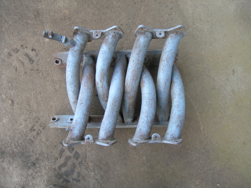

Date: May 08, 2009 05:40PM
How about this -- for only 3,000 pounds (!!!)?
