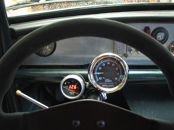

The Sun Super-Tach II in my MGB was old and second-hand when I got it 25 years ago. Apparently, it's not going to work easily with my new ignition system. (There's a trick for connecting real old tachs involving wiring up a coil from a gutted relay to simulate a coil's inductive spike, but I'm not especially keen to do that.) Replacing my tach with a newer version of "Super-Tach II" would probably fix the problem too - and they only cost $40.
But just for the grins I thought I'd ask... What features do YOU look for in an aftermarket tachometer?
Do you have a strong brand preference?
my starting point:
http://www.britishv8.org/MG/CurtisJacobson/CurtisJacobson-BI.jpg

Well... not much happened with this from February until today. I learned Stewart Warner did manufacture a 0-8000rpm electronic tach to match my other gauges, but apparently they didn't make many before going out of business. I've seen exactly one on eBay, but I got outbid on that one.
So, today I made an adapter to facilitate using my vintage Sun tach indefinitely. I had it together before I remembered to take a photograph... so this snapshot is after the fact. You can't really buy just one transistor, just one resistor, etc. - so I had spare parts and I laid out some of them as examples. Also, as you can see, I "potted" my adapter circuitry in a 35mm film canister to protect it from vibration. The adapter seems to work perfectly so far!
p.s. See the little circuit diagram on the side of the relay? See how there's a resistor inside, wired in parallel with the coil? If you're making a similar adapter, you'll want to pry open the relay and remove that resistor. I ended up removing everything but the coil.
